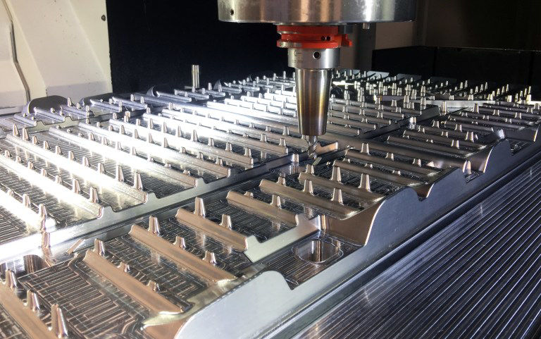

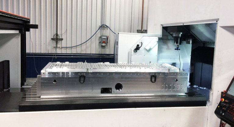

The first requirement of high-performance tooling was met when Lifetime began utilizing OSG end mills. Lifetime’s previous tooling choice was a 3/8” 3-flute end mill that was used at 6,000 rpm and 60 ipm. The second requirement was met with OSG’s HY-PRO shrink fit holder and shrink fit technology. OSG’s balanced holder gave Lifetime the ability to mill in excess of 20,000 rpm. The fulfillment of the first two requirements has greatly improved tool life and performance at Lifetime. However, further progress was held back because Lifetime’s older machine tools are incapable of running high speed machining programs. It all changed when this past year, a new Mazak FJV-60/120 vertical mill arrived with look ahead controls designed for high speed machining along with a high-pressure coolant through spindle. With the equipment update, Lifetime is now able to fully leverage OSG’s Exocarb Aero Blizzard high performance carbide end mill.

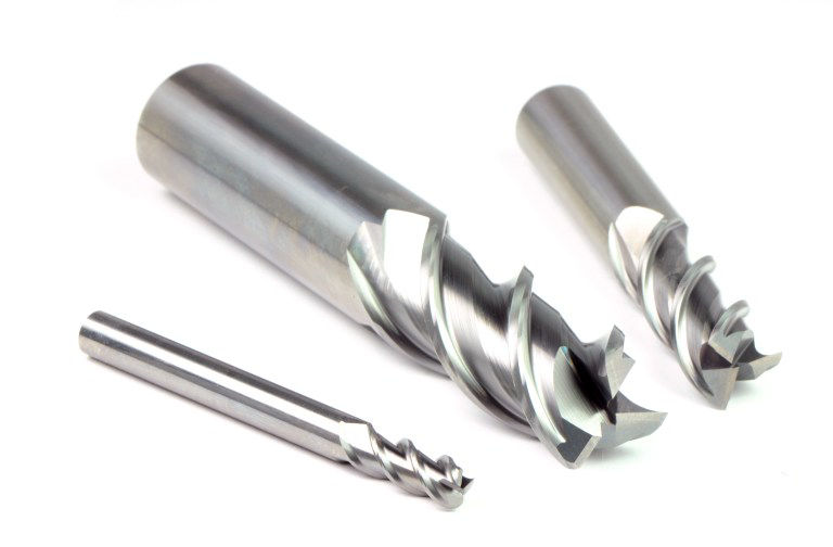

The Exocarb Aero Blizzard series is a part of the OSG premium line of carbide high performance end mills specifically designed for aluminum and copper alloys. The series’ special end cut gashing and offset teeth permit large depths of cut and maximum feed per tooth. Made with polished flutes to enhance tool life and reduce built up edges, the Blizzard end mill series is engineered to yield high metal removal rates in roughing applications while providing a superior finishing.
The Exocarb Aero Blizzard series is a part of the OSG premium line of carbide high performance end mills specifically designed for aluminum and copper alloys. The Exocarb Aero Blizzard end mill series is available in various end styles, such as square, corner radius and ball.

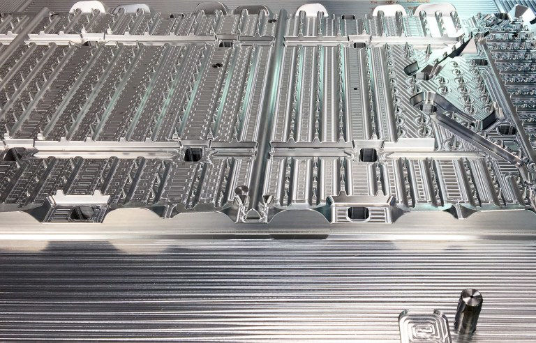

Combined with the new Mazak vertical machining center, OSG’s 3/8” 3-flute Blizzard end mill is now able to reach its full potential, with parameters as high as 15,000 rpm and 220 ipm to generate unparalleled results in productivity. These improvements across all the different milling operations at Lifetime have created an average of 25 percent cycle time reduction. A typical mold is now machined and built in less than 12 weeks, down from an average of 16 weeks. In addition to increased speeds and metal removal rates, Lifetime also saw much improved surface finish, which lowered labor costs by reducing the amount of labor time needed to polish the cavity components of each mold. The combination of a quality tool with precision tool holder engages the workpiece in a more rigid and stable environment, thus resulting in a better surface finish. The overall polishing time was reduced by more than 75 percent. Mold polishing in general added 40 hours to the mold build time, which has now been reduced to eight hours.
Combined with Lifetime’s new Mazak vertical machining center, OSG’s 3/8” 3-flute Blizzard end mill is able to reach its full potential, with parameters as high as 15,000 rpm and 220 ipm to generate unparalleled results in productivity.
