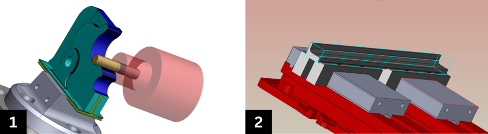

1. A CAD/CAM model of a part made from 13-8 stainless steel. Image courtesy of Allied Tool & Die.
2. A CAD/CAM model of an aerospace bracket made from Inconel 718. Image courtesy of Allied Tool & Die.

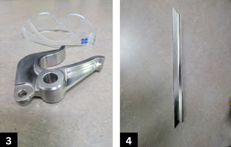

3. A part made from 13-8 stainless steel that was machined by OSG's HY-PRO® CARB VGM end mill
4. An aerospace bracket from Inconel 718 that was machined by OSG's HY-PRO® CARB VGM end mill
