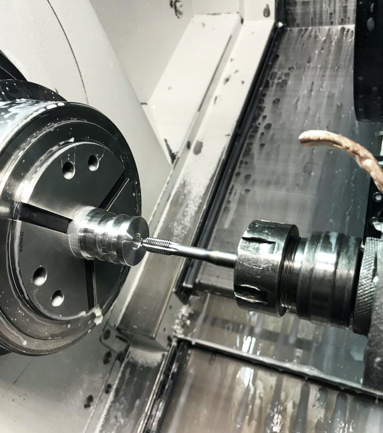

One of Flickinger Industries’ larger customers is a well-known world leader in motion and control technologies. The company has been producing aluminum air cylinder pistons in sizes ranging from 1/2” diameter up to 3” diameter and in lot sizes of typically 2,000 to 5,000 pieces – totaling over 1 million pistons per year. The parts are made from T356 aluminum bar stock and each piston has a threaded center hole. The thread finish needs to be free of smearing and burrs that would hamper assembly. Threading the center hole is challenging because the tool is stationary, while the part is rotating. Flickinger Industries was using a competitor cut tap for many years and became accustomed to periodic catastrophic tap breakage inherent with long chipping materials like aluminum. In early 2019, a breakage damaged a lathe turret, causing excessive downtime and costly repairs. It was at this time that I visited Flickinger Industries with a distributor, and discussed the issues caused by the lack of chip control. The tool being used at that time was a competitor 5/16”-24 cut tap in bright finish, spiral fluted with modified bottoming chamfer in 2B class of fit. I showed Flickinger Industries OSG’s XPF forming tap series and explained how chip control issues would be a thing of the past by utilizing form taps, something the company knew of, but had never thought would remedy to their issue.

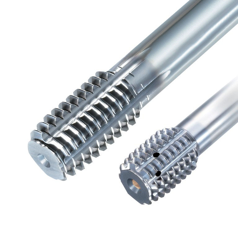

Because a forming tap forms screw threads through plastic deformation of work material, no cutting chips are created. With no cutting chips, chip evacuation troubles can be completely avoided. The XPF is OSG’s high performance forming tap that produces no chips and is optimized for machining materials up to 35 HRC. It is uniquely engineered with a low-torque design to facilitate longer life at faster speeds. Its V coating also enables extreme wear resistance. The XPF is available with or without coolant holes, and in standard or long shank style.
After a detailed evaluation of the application, I offered to bring a test tool of the OIL-S-XPF tap under OSG USA’s guaranteed trial order. The XPF tap has been one of my strongest weapons against the competition. It has claimed victory in several materials, competing against every well-known manufacturer in the market. For the machining, Flickinger Industries uses a Mori Seiki SL lathe and WSO emulsion coolant at 12 percent. As anticipated, the trial was a major success. Within the first 10 minutes, the operator commented “That’s twice as fast as the old tap!”

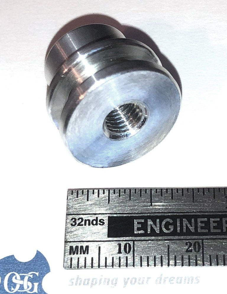

The competitor cut tap required approximately 20 seconds per part, whereas the XPF forming tap only needs 10 seconds. During periodic spot checks for pitch diameter and thread finish, all were well within optimal specifications. Normal tool life for the previous competitor tap was 3,000 pieces, which the XPF achieved and surpassed with ease. Flickinger Industries’ Plant Manager Tom Schroeder said he was ‘…sold on the XPF since we are saving so much time per part.’
The first test tap completed over 14,000 pieces before some slight thread galling was observed, but the tool could still continue to be used. The second test ran just as well as the first, and the next question from Flickinger Industries was “Does OSG make the XPF in 1/2”-20 and 7/16”-20 thread sizes?” And the answer is “Yes, we do!”
Tool life for the OIL-S-XPF is now set at 10,000 pieces as the standard, even though testing has proven that they could carry on further. Nevertheless, the cost per unit dropped from $0.017 to $0.006 per part, enabling an estimate annual cost savings of $37,775. I’m proud to say that today, every aluminum piston made at Flickinger Industries uses taps from OSG’s XPF series. By employing OSG’s XPF forming taps, Flickinger Industries is able to resolve chip control issues, reduce breakage, and avoid future machine damage to maximize performance.
